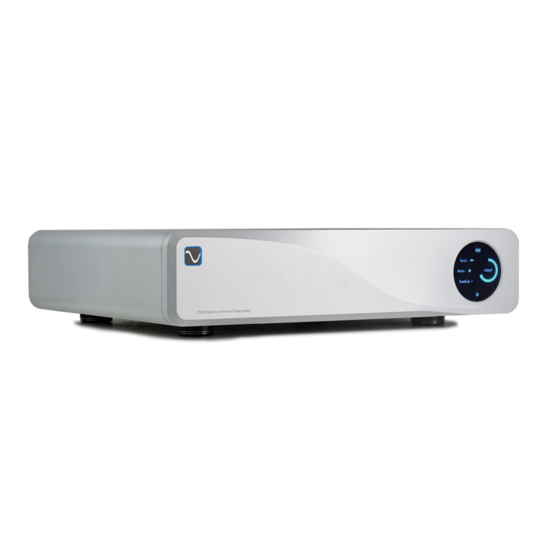

Designed for a reference turntable and cartridge

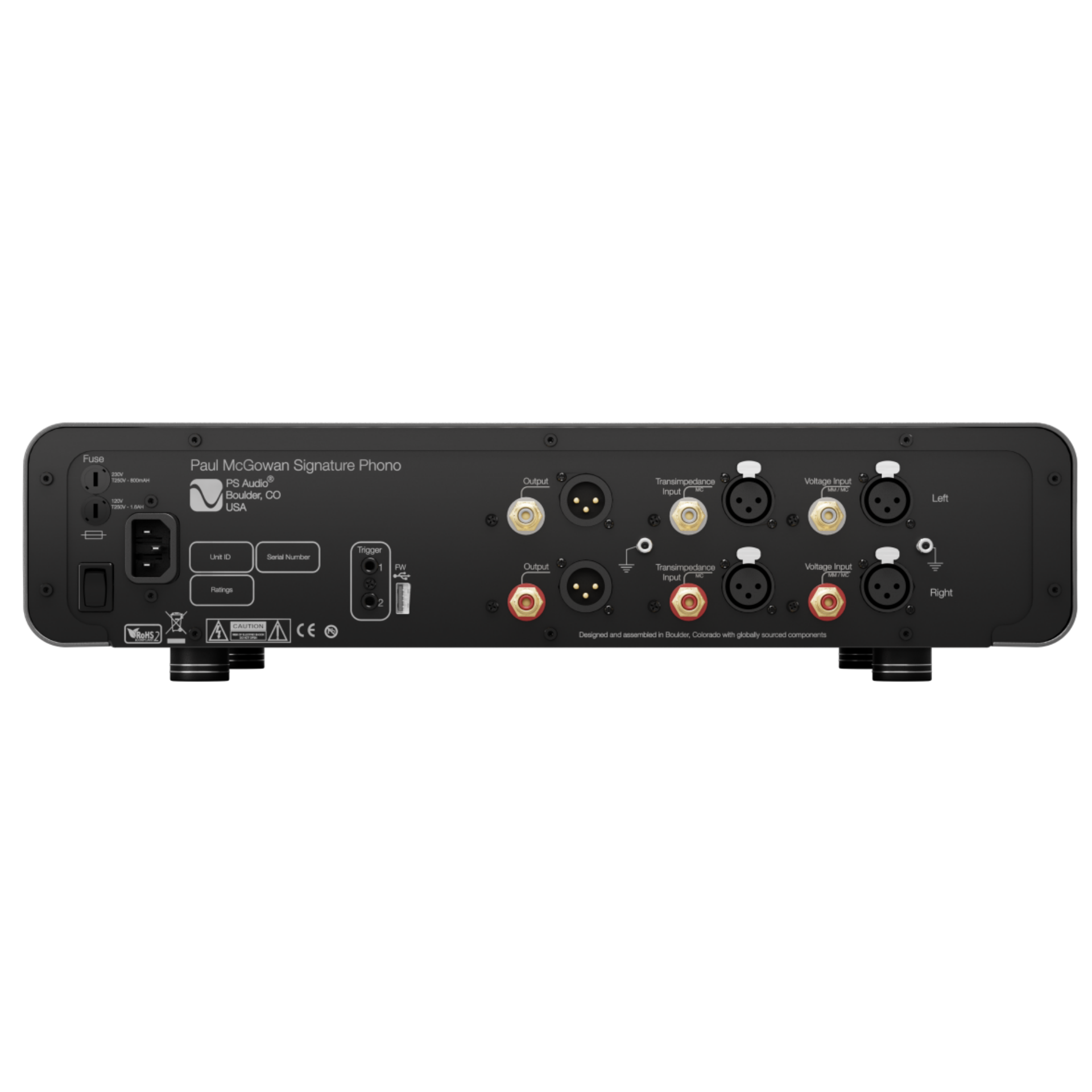

  • Connections Two tonearm inputs, balanced XLR output
  • Cartridges Moving magnet and moving coil, fixed and variable loading
  • Circuit Zero feedback, Class A, Diamond buffers
  • Gain 70 dB, for cartridges down to 0.15 mV

PS Audio’s very first product in 1975 was a phono preamplifier that helped launch the company—and a movement toward better sound. Now, after 50 years of relentless innovation, we return to our roots with something truly extraordinary: the PMG Signature Phono Preamplifier. Designed by Darren Myers and bearing the name of our founder for the first time, this phono stage is unlike anything we—or anyone—have ever created.
At its heart is a groundbreaking zero-feedback architecture, a first in PS Audio’s history. This unique topology allows for something remarkable: the true separation of vinyl surface noise from the music itself. Once you hear it, you can’t unhear it—and you’ll never go back. Surface noise floats in the background, untethered from the performance, leaving the music alive, present, and shockingly real.
Adding to its revolutionary nature is an optional pure current-mode transimpedance input, ideal for low-output moving coil cartridges. This input requires no cartridge loading, offers unmatched transparency, and opens a window into your records that traditional voltage-input designs simply can’t match.
With fully discrete Class A FET circuitry, massive headroom, and support for all cartridge types, the PMG Signature Phono Preamplifier is a triumph of analog engineering—and the finest phono stage we’ve built in our 50-year history. From the first needle drop, you’ll know: this is vinyl reborn.
Overview
A revolutionary new design
At the heart of the PMG Signature Phono Preamplifier lies a bold and uncompromising design decision: the complete elimination of global feedback. Using high-voltage discrete FETs and hand-selected bipolar transistors in a fully complementary topology, designer Darren Myers achieved something few engineers have dared attempt—a true zero-feedback phono stage with vanishingly low noise and distortion.
Why does this matter? Because feedback, by its very nature, must first allow an error to occur before it can react. It listens after the fact—correcting mistakes only once they’ve already made their way into the signal. While useful in keeping measurements tidy, this reactive approach often smears transients, dulls dynamics, and blurs the natural timing that gives music life.
Building a zero-feedback circuit that remains stable, quiet, and linear is an immense engineering challenge. It requires extreme precision, deep understanding of device behavior, and countless hours of tuning. But the payoff is extraordinary. Music flows with an effortlessness that’s hard to describe—organic, untethered, and free. Surface noise retreats into the background, and the performance detaches from the speakers, alive with texture and presence.
This isn’t just a phono stage—it’s a masterclass in analog purity. With the PMG Signature Phono Preamplifier, vinyl is no longer colored by circuitry. It simply... is.

Features
At a glance
  • Class A balanced analog output stage
  • Zero feedback folded cascodes
  • Fixed and variable loading
  • Balanced XLR output
  • 70 dB of ultra-low-noise gain, for cartridges down to 0.15 mV
  • Two inputs, for two tonearms
  • Transimpedance input
  • High-current oversized analog power supply
  • Discrete FET design
  • No capacitors in output signal path
  • Class A analog circuitry
  • Diamond buffers throughout

PMG SIGNATURE PHONO PREAMPLIFIER
Unit Weight30 lbs / 13.6 kg
Unit Dimensions14 3/4” x 17 1/2” x 4 3/8” (with feet) 375 mm x 445 mm x 112 mm (with feet)
Shipping Weight34 lbs (15.4 kg)
Shipping Dimensions20 1/2” x 24” x 10” 521 mm x 610 mm x 254 mm
Color OptionsBlack Silver
Voltage Options (Factory set only)Auto Voltage: 120VAC or 230VAC 50 or 60Hz
Fuses120V: T250V-1.6AH (1.6A Slow Blow) 230V: T250V-1AH (1A Slow Blow)
Accessories IncludedUS (NEMA 5-15P) (100V/120V versions) Schuko (CEE7/7) (230V version) UK (BS1363) (230V version) Remote Control
Audio InputsMM or MC: XLR or RCA TZ: XLR or RCA
Audio OutputsRCA (Unbalanced) 1 Stereo Pair XLR (Balanced) 1 Stereo Pair
DC TriggerInput: 3.5mm (2) 5-15VDC
PerformanceAll measurements are with both channels operating, gain set to low, and balanced outputs. Input frequency is 1kHz.
Input Loading47K, 1K, 470, 320, 200, 140, 100, 67, 40, 30, 16, 12
