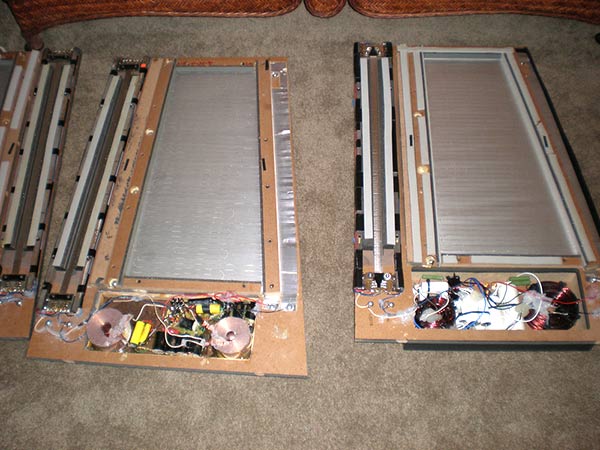

One of the most challenging loudspeakers of all time was the infamous Apogee from the late Jason Bloom. These were full range ribbon speakers that gave pause to just about any amplifier. If you could find one powerful enough to drive the Apogees, ignoring their silly low impedance of 1Ω, you could get some pretty magnificent sound.
Here's a picture of the inside workings of an Apogee ribbon.
What you might notice in this photo is the shiny aluminum strip. That's the ribbon, and as promised, I will attempt to explain how a ribbon speaker works.
Ribbons move air by means of their namesake. The moving ribbon is typically made from very thin and light aluminum foil—a simple strip that is either straight or pleated (a traditional ribbon) or folded (an AMT). The ribbon is held tight on its top and bottom and free to move along its edges. Those edges are surrounded by powerful magnets. Like the voice coil of a conventional driver, power from the amplifier is applied across the metal ribbon, which in turn develops a magnetic field. As we remember, this moving magnetic field opposes and attracts the permanent magnets along the side and thus it moves, pressurizing the air and we hear music.
