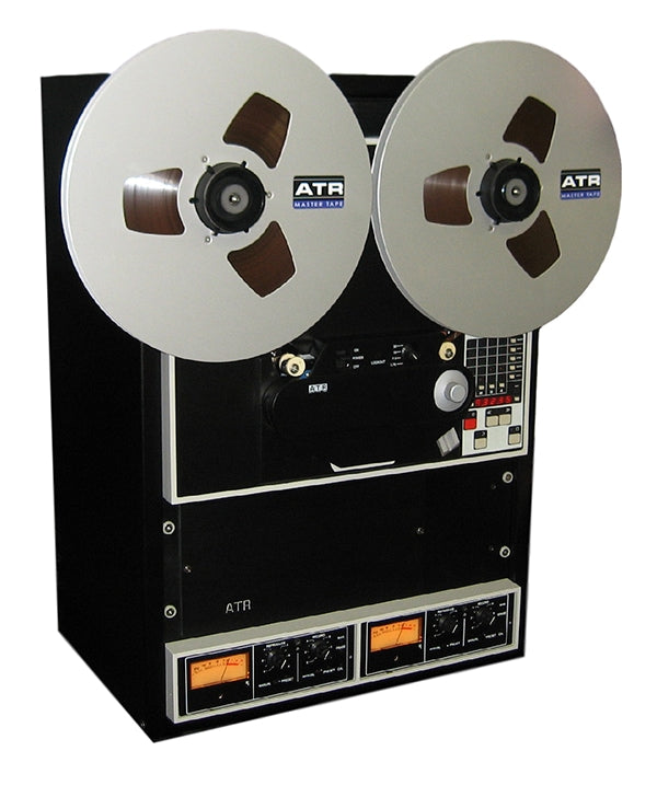

Header image: an Ampex ATR-102 sold by ATR Services, Inc.
