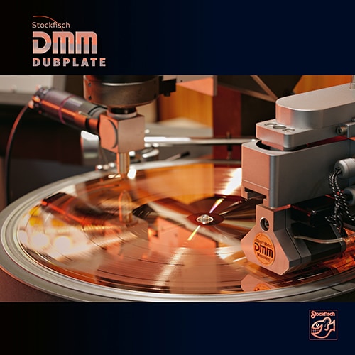

Enter the DMM Dubplate Vol. 1. As previously discussed, the DMM process can directly produce a metal mother right there on the disk mastering lathe, with no further steps required. Not only does this eliminate the possibility for any losses between the mastering stage and a subsequent electroplating process, but it also comes with the correctly-sized center hole to fit a conventional turntable platter, and since the mother is cut on the lathe, its accurate centering is maintained!
The Neumann VMS-82 cutting lathe at Stockfisch Records.
The blank disks used for the DMM process are made of austenitic stainless-steel substrates, plated with a layer of copper phosphate. None of these materials is ferromagnetic, affording total freedom in the selection of a playback cartridge for the DMM Dubplate.
Naturally, there are challenges to making this happen. While the center hole and centering are no problem, the normal DMM blanks are 14 inches in diameter, instead of the usual LP size of 12 inches. The flatness is not tightly controlled, as they are normally kept flat by the suction of the Neumann VMS-82 cutting lathe’s vacuum platter (the VMS-82 is the cutting lathe used by Stockfisch Records, and the only disk mastering lathe designed specifically for the DMM process). DMM disks are also considerably thicker than a vinyl record, not to mention heavier. The team at Pauler Acoustics tackled these challenges by creating a DMM disk that is just over 12″ in diameter, able to fit on any turntable. They do their own, in-house flatness quality control, so only the truly flat DMM blanks are used for making DMM dubplates. The DMM dubplates remain thicker and heavier than a vinyl record, but this shouldn’t be an issue on any reasonable turntable.
As the DMM disks are cut on a lathe, the process leaves absolutely no room for mass production methods. The DMM dubplates have to be cut one by one on a lathe, in real time, by a real human. As such, each one is unique, with the customer’s name handwritten on the label. I shouldn’t have to point out that this is a very time-consuming and expensive process, requiring skill, passion, experience and extremely rare equipment. In view of this, while the cost of the DMM Dubplate Vol. 1 is much higher than a vinyl record or even a master tape copy, knowing what is involved in making it, I feel it is very reasonably priced, if not an outright bargain. That was before I got to listen to it…
