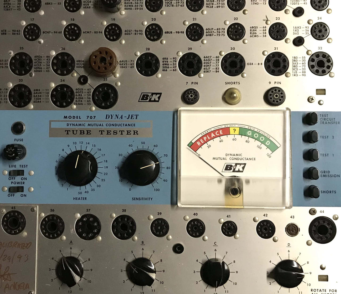

What do we need to test to ensure the tubes are working correctly? Open or shorted filaments can be detected using a multimeter, and should be done before plugging the tubes in. Set the multimeter to measure resistance and connect the meter’s test leads to the filament pins. (You can consult on-line tube manuals for the pin configuration. For testing other parameters, a tube tester is needed.)
I have a George Kaye Small Signal Tube Checker that I find very handy for testing smaller tubes for emission, gain, noise and microphonics (the tendency for a tube to literally act as a microphone; you can sometimes hear an audible “clunk” or “ring” when tapping on such a tube when an amp or preamp is on). The tester tests for distortion level when the tube is overdriven; the distortion level rises when the tube’s emission falls, due to aging. The gain is measured at one operating point only, but this is adequate for tube matching in less-critical circuit positions. The noise and microphony test is very useful, as the tester allows you to actually listen through headphones as well as see the noise level on a VU meter. I use this function to sort tubes (from least to most noise) for use in the phono stage, the input stage, the driver stage or the output stage of phono stages, preamps, integrated amps and power amplifiers. Unfortunately, this tester is no longer made, and it can only test small-signal tubes like 12AX7s, not bigger power tubes. However, I mention its use in order to outline what to look for when testing tubes, and I’ll cover other vintage and current tube testers a bit later.

Ideally, tubes should be matched for emission and transconductance (the change in plate current per unit change in grid voltage). However, with most tube testers, transconductance is measured only at a single operating point. To match tubes at a variety of operating points, a curve tracer is needed.
The most popular tube tester in history was the TV-7 Series, which was made for the US military by Hickok and others. At one time these testers could be picked up at the second-hand market for very little money, but they themselves use tubes and need to be restored and calibrated in order to perform correctly. Audio clubs with sufficient funds and expertise should invest in a laboratory-grade tube tester for their members’ use. The best vintage examples of these include the British AVO VCM 163 and the German Neuberger RMP370. My recording partner bought two AVO163s and used one as a parts donor to restore the other. The tester is a great piece of British engineering, and a real pleasure to use. Vintage tube testers were also made by B&K, Eico, Knight, Precision Apparatus Company, Sencore, Heathkit and others.
