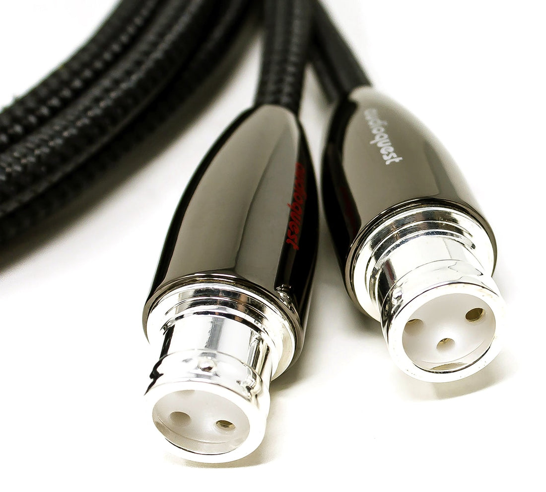

When my daughter had her new baby in December, we stayed at their house for five straight days, watching after my three-year-old grandson Henry, their two dogs, and a pair of guinea pigs. Prior to heading over there, I turned off the audio system and disconnected it from my home network, just in case there were any lightning events while I was gone (I didn’t yet have the fiber media conversion setup in place yet that would have protected the network-connected equipment from that possibility). The morning after we returned, I went back downstairs and reconnected and rebooted everything to get some music playing, and immediately noticed a problem. The right channel continuously fuzzed in and out, as if there was some kind of short. I went immediately over to the equipment stack, started futzing with the interconnects between my preamp and amplifiers, and when I jiggled the AudiQuest Yukon balanced cable in the right channel amp input, that exacerbated the situation. Holy crap, these cables were less than two years old – had one of them developed a short already?
![The AudioQuest Yukon balanced interconnects are exceptionally well-made.](https://cdn.shopify.com/s/files/1/0672/2283/1394/files/AUDIOQUEST-YUKON-XLR-1.jpg)
I have a huge box of cables in the storage area of my basement, and pulled out the Blue Jeans balanced cables that the AQ Yukons replaced. That totally solved the signal problem. The sound was now restored to a perfect level of connection, but it also sounded flat and lifeless. I reached for the Yukons to reconnect and take another listen, and at that point, I noticed that the silver input connector of the balanced cable was almost completely black with tarnish! I’d handled these cables countless times over the last couple of years, especially with the almost constant flow of review equipment in and out of my system, but had never previously noticed anything in their appearance that drew my attention – they'd always looked perfectly pristine. It was almost as though the tarnish appeared out of nowhere; the process could possibly have gotten accelerated when my system was completely down for months while my preamplifier was away for repairs. Regardless, this caught me completely off guard!
![The "silver" polishing cloth (on the left) was actually silver in color before removing all the tarnish from the connectors.](https://cdn.shopify.com/s/files/1/0672/2283/1394/files/polishing-cloths-1167x1024.jpg)
I scrambled, located one of the silver polishing cloths, and proceeded to thoroughly polish, rinse and clean the connectors on all my silver-clad cables. And they all showed some level of tarnish and blackness, though none of them were anywhere near the level of the right-side balanced Yukon cable. By the time I finished cleaning multiple sets of interconnects, loudspeaker cables, and HDMIs, the formerly light-silver colored polishing cloth was now a very dark gray with the tarnish it had removed! After everything was reconnected and rebooted, the sound was restored to its previous state of audio glory. I was astonished, if perhaps a bit embarrassed by my negligence. I happened to think afterwards, that during the period from early August until November, when my PS Audio Gain Cell DAC/Preamp was off for repairs, that all the interconnect cables were just lying about the room, unconnected. Maybe this had accelerated the tarnishing process? The room is climate-controlled, so there are no temperature or humidity issues, so who really knows. But I’ve definitely learned my lesson: unless you’re using anything other than gold-plated connectors, you need to check them for cleanliness periodically. Probably once a year would be sufficient, and I definitely would still recommend getting an appropriate contact enhancer to assist with the inner pins of balanced and single-ended connectors and the like. Believe me, this stuff really does make a difference!
