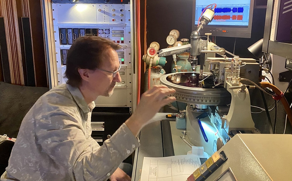

    JIA: Do you also cut masters from the ATR-100/MR-70, or do you only use the Studer A80 preview head tape machine for that?
    Greg presenting a freshly-cut lacquer master disk, in front of his Neumann VMS-70 disk mastering lathe. Greg presenting a freshly-cut lacquer master disk, in front of his Neumann VMS-70 disk mastering lathe.
    GR: I primarily use the A80. I have cut directly from the ATR-100/MR-70 but only for short sides when fixed pitch disk mastering is possible. I mostly use the ATR-100/MR-70 for creating cutting masters when doing 100 percent analog cuts. In that case it goes like this: client mix tape on the A80 → analog mastering chain → ATR-100/MR-70 → EQ’d cutting master. Then it’s back on to the A80 and directly into the Neumann VMS 70 cutting lathe.

    Greg’s Neumann SX74 stereophonic cutter head, on the Neumann VMS-70 lathe. The little tube at the front delivers helium to the cutter head, to assist with cooling the drive coils, which operate in a helium atmosphere. (Helium has a higher thermal conductivity than atmospheric air!)
