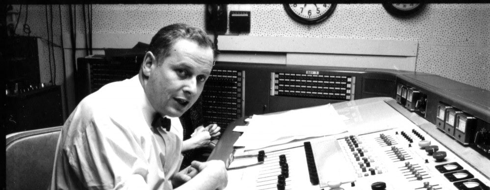

[Header photo is of C. Robert Fine at the Westrex recording console at Fine Recording Bayside, Queens, which was originally the Everest Records studio. All photos courtesy of Tom Fine.]
