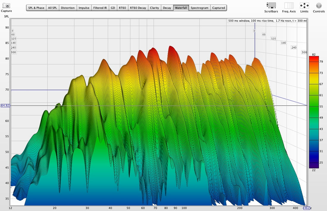

REW has many other useful functions. It can generate a waterfall plot of the speakers’ frequency response that is derived from the impulse response. This is very useful for evaluating the effects of room modes, as well as identifying some design flaws of your speakers that perhaps you would rather not know about. It can also calculate the reverberation time of the room (the RT60, or the time it takes for the sound source to decay 60 dB), although this only applies to larger spaces. This is an important parameter to measure for recording venues.
Waterfall plot of one speaker between 0 and 500 Hz. The ridges indicate room modes causing standing waves. Waterfall plot of one speaker between 0 and 500 Hz. The ridges indicate room modes causing standing waves.
