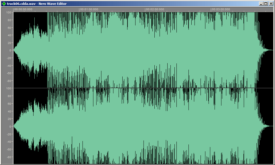

Back in the day when the vinyl record was the main consumer format, things were not yet as bad, since that medium does not have a strict upper level limit. But then came the CD and with it, digital audio. Nothing is allowed to exceed 0 dBFS, but the loudness wars resulted in nothing being tolerated to fall much below -3 dBFS in modern pop music either. This leaves us with a dynamic range of 3 dB…in other words, no dynamics. They have been sacrificed for the sake of higher average (apparent) loudness. It doesn’t sound better, just louder. There are even commercially released CDs with a dynamic range of just a fraction of a dB!

Dynamic range, LP. Courtesy of Wikimedia Commons/Audiofreak82.
Dynamic range, remastered for CD. Courtesy of Wikimedia Commons/Audiofreak82.
