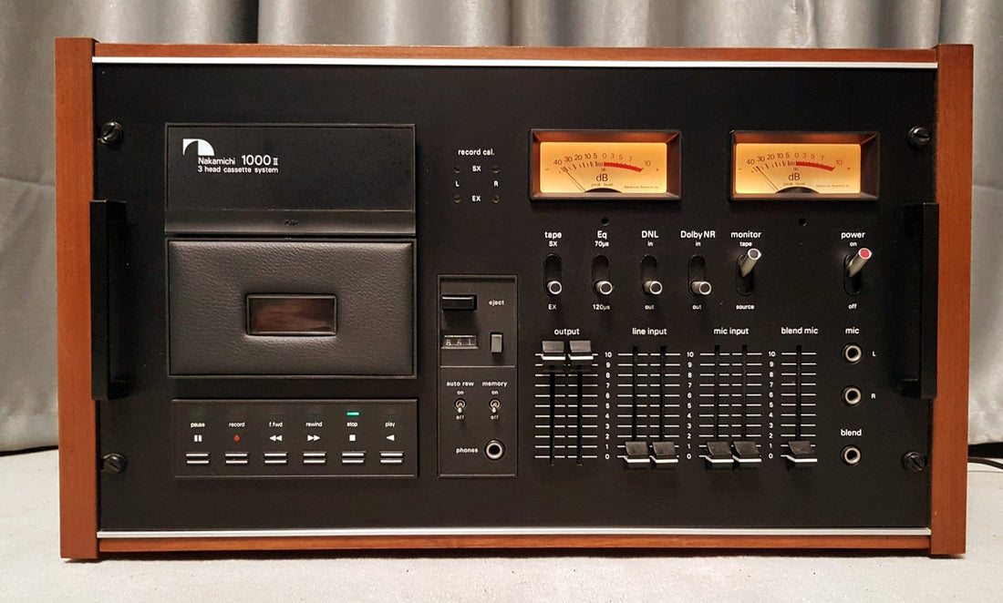

When thinking of the ultimate cassette deck, many people think of Nakamichi. The company made some of the most impressive cassette decks ever. They were used by audiophiles and professionals, but were rarely found in professional recording studios for capturing audio. The Nakamichi 1000 was popular with not only audiophiles but also with computer programmers in the late 1970s. It was used as a deck for recording computer data to cassette tape, for use by the Commodores, Ataris, Amstrads and other computers of that era. While these computers had their own cassette decks, they were often cheaply made and not considered reliable for recording data for critical uses.

Header Image: Nakamichi 1000 cassette deck. Photo courtesy of Thomasz Gaca.
